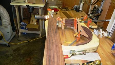

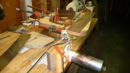

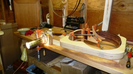

Starting my second guitar made of Madagascar Rosewood. Bending commenced today, thought I'd share some pics.
The bending iron is a piece of aluminum tubing with a 200W Halogen bulb and a dimmer switch.
The tough thing is keeping twists and flat spots out of the sides. I learned on my first that I could go back and "clean up" the little discrepancies after the main shape has been formed. There is a slight twist developing right where the tail block will reside.
I've had this wood sitting around and its been calling my name ever since I bought the OLF SJ mold and plans!! Couldn't wait. My first guitar just needs a headstock inlay, finish, etc. I seem to like the building rather than the finishin details like frets, etc!    Hopefully starting number two will give me impetus to finish number one
Thanks for looking,
Pete

That is a great start. I like that bending iron, and it looks like it works just fine. What kind of top are you putting on it?
Jeff

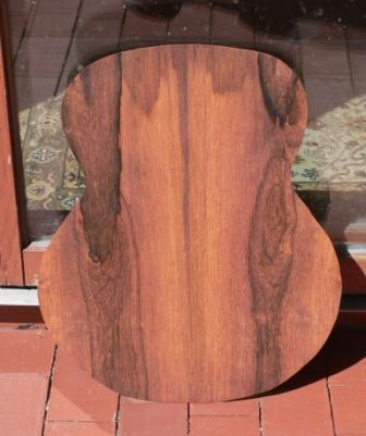

How about a pic of the back that goes with those sides?
Mind if I ask where you got the MadRose?

Dave - I bought the Mad Rose from Allied Lutherie, nice looking wood, much heavier than the Walnut I used for my first guitar; beautiful stuff
